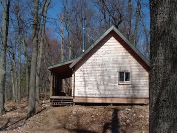

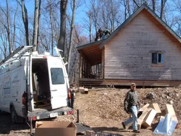

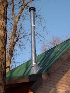

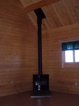

Here are three photos I posted in another thread, to show what was required for minimum clearance on my 12/12 pitch roof. Also, to explain why I paid professionals to do it!
Obviously, the chimney needs to be guyed (you can see the supports if you click on the photo). The roof peak is 18' above the cabin floor and the flue exit from the back of the stove is about 2' off the floor, so the overall flue/chimney length was about 18', to get it 2' above the peak (which was within 10' horizontally). I have no idea how I'll clean it, other than from inside the cabin with one of these:

Here's a better photo of the chimney supports.

That's about the way our flue worked out leeave. Maybe you can pull off the top length to get easier access for cleaning? Be sure to order a brace too. It will need one at 5ft.
