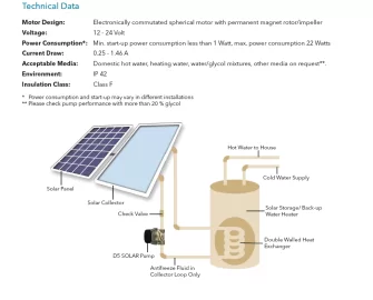

    You can also buy DC circ pumps. I've used these on solar systems powered from a 30W module, or power them from a battery. That would save the cost of the inverter and the efficiency loss thru it. Not as powerfull as that 70W pump, but it may be enough for your application.

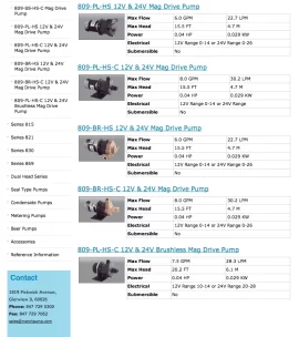

    I have not used the El Sid. I have used and removed a handful of the Marsh 809 12V DC pumps. Very durable, noisy and not as efficient as the ECM based Laings however.
