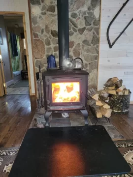

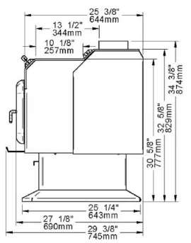

I have a question for anyone who may own an HT2000, I have reviewed manuals and done the math based on the manual multiple times, but there is one measurement I cannot find, from the front of the stove to the front of the flue.
I have an existing Osburn, with slate tile all around on the floor, and I am hoping to replace it straight in and out, my chimney goes straight up and would like to keep it that way, but I also have to maintain 18 inches from the front of the stove on the floor to combustible materials.

By front of the stove, I am assuming to the front of the door glass. I don't have one to measure, but I think 15" or 15.5" would be close. If necessary, perhaps the front of the hearth could possibly be extended?
HT2000 Dimensions
I appreciate your reply, I have all those drawings. I dont want to assume anything, and I am trying to avoid extending hearth.
My math puts me closer to 16", which would make it about only 16" clearancce in the front, not the 18" required in Canada.
Sounds like it may not work without a bit of compromise. The HT2000 has a deep firebox. The extension could be a strip of metal, flush with the floor. Perhaps also look at the Drolet HT3000 which is slightly shallower?

I have decided to extend my slate tile on the floor with a 4" border all around to make it look like thats how it was installed.
