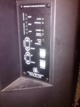

Had a customer with a lousy board in his Saranac. Also I had a old St. Croix #3157 board lying around. Plug and play baby, plug and play. All I can say.

The problem is that Hudson River discontinued the Saranac and the boards that went with them are no longer supported. If you get a new board it is the same as the old ones and they all have the same electronics problem. Paying $219 for the same bad Chinese board does not make sense to me.
The York board worked perfectly. I ran it for well over an hour watching the change in fire every 9 minutes up and then back down. I set the draft for a high draft install (less mechanical air in) and seemed to do better at getting an acceptable flame height.
I hear ya all about mods and possible unsafe conditions,,..sometimes it works out, other times it doesn't. This time it did.
