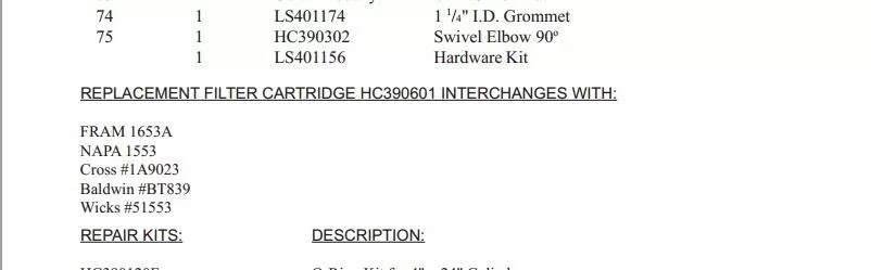

1) I need a new hydro filter. I dented this one on a sapling. Can't find it anywhere. Manual has a part number of 390601a0, anyone know a replacement?

A few seconds with Google.............................. Start here...
accidentally got a bunch of those filters for my 35 ton speeco (huskee) .. if dent is a small one .. wouldn't worry about it
those hydraulic filter last a long time .. at least mine has given no problems. did replace just because.
that was 2-3 years ago .. probably should change it again .. 35 ton speeco sure has been a good splitter!!!
