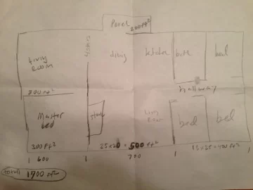

    I'm in Mass. and looking to add a wood insert as primary heat and hopefully avoid oil. I'm in a raised ranch, and the fireplace is in the middle of the house in an open layout room 600sq ft (kitchen, dining room, living room). I would like heat to reach the other rooms as well down the hallway (3 bedrooms, bathroom). I have ceiling fans now to help. Total square feet is 1800 sq ft on this level.

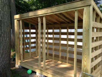

    Welcome to Hearth.com and congrats on that nice wood shed. Hopefully it is full now with lots of ash and other easy drying wood for the coming heating season. Keep splitting and stacking the wood. If it's oak it'll need a couple years to season.

    Nice job on the shed, I am looking to build something like this, can you give your dimensions and approximate cost please? Thanks

    Very nice woodshed . . . hopefully the floor is plenty beefy . . . wood weighs a lot. Just split recently? This wood may or may not be ready to go this Fall . . . will depend a lot on the weather conditions, how it was stacked, how small it was split and most important of all -- the species. If it was oak, forget it . . . other species you may luck out and have it at least semi-seasoned. Two cords? You will most likely need about double that amount . . . especially in the first year if you're planning on burning 24/7.

    I went to my local dealer today and decided on the Lopi Freedom. The only question remaining is my wife wants to get this stove with the flush mount kit. She's nervous about the kids and thinks the flush mount would be better. Any advice between the flush mount version or the extended?
    Also, attached is the house layout. thanks again.

    I built the shed 12' W x 7' H x 5' D. Once the base was built and level, the rest was pretty easy. Used all PT wood. Total Cost around $450.

    Congratulations to your purchase! I assume the dealer made sure it fits your fireplace? I would get the extended version. You will need a gate anyway and with the stove protruding onto the hearth you will have more heat when the power is out and you may even be able to warm up some soup or similar on those occasions.
    The location for the stove is great; should be easy to heat the whole house. If the bedrooms on the right get a bit cold a small desktop fan on the floor at the end of the hallway blowing cold air towards the kitchen will works wonders. Between the dining room and the living room on the left it says 4 stairs; are those going up or down? If that room is lower than the others you may also have some problems heating that up properly. Otherwise, have fun burning!

    If the stairs are going up you should be golden. Is the wall of the master bedroom the back of the fireplace and lined with brick? If that's the case you may get some beautiful radiant heat in your bedroom when the stove is running. That happens with our fireplace where the back radiates into the stairwell.
