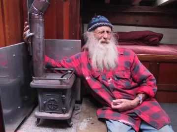

    You got it. :)
    For privacy reasons, I won't show my personal setup, but here is a link to several pictures of people using the type of stove I am using:
    http://www.marinestove.com/installation_views.htm
    Some of these installations are, of course, land based, but the stoves are primarily designed for marine use.
    The attached picture is my favorite one from this gallery... this guy is the best character ever!

  11. karri0n New Member
    joined: Nov 18, 2008
    1,148 posts
    Eastern CT
    Sully himself, of course, has a much bigger beard, a pegleg, and an eye patch.

    Just as I pictured him - but you forgot about the gold earring in one ear... :coolhmm:
