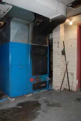

    1. The original structure is heated by forced hot air, currently supplied by a Powrmatic combo wood/oil furnace located in the basement. It's old and tired.

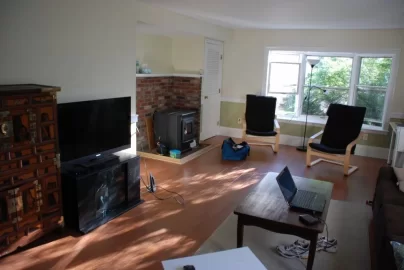

    3. An Englander pellet stove resides in the first floor addition and can easily heat the living/dining room and kitchen. This, too, is not in the best shape.

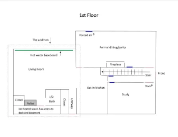

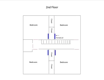

    I have included the 1st and 2nd floor plans indicating location of baseboard, registers and the pellet stove. The master suite is on the 3rd floor and is essentially an open room, again heated by baseboard.

    - In the attached floor plan, there is a fireplace in the formal dining room. Would it be possible to install a wood or pellet stove, and modify the existing ducts to distribute the heat? Given the location of the ducts and the stairs, it looks as if there will be good convection.

    BTW that is ALOT of blackness on that ductwork!
