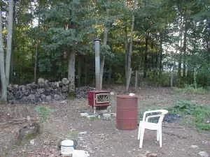

    I have one outside. Though it isn't repainted yearly the rusting isn't too bad. If you regularly paint it you should be fine. Lots of steel barbecues and smokers out in yards and the elements.
    This one isn't mine.

    Agreed, though BBQs and that PE stove are porcelain jacketed which does stand up better to the elements.

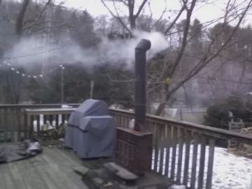

    Our old Franklin Stove went out on the deck when we installed the Fireview. Its been outside for 4 years now. I wire wheeled and painted it once, but it is pretty much covered in rust now. It still seems solid enough to contain fire though.
    The stack helps to keep the smoke out of our eyes. A fire makes it much more comfortable to be outside on a spring, fall or even mild winter night.

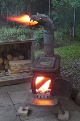

    I like this dragon!
