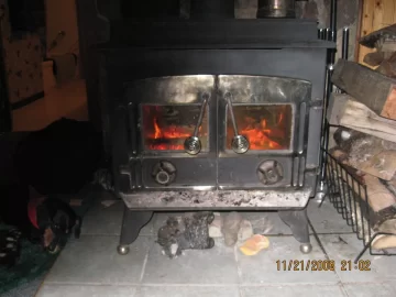

I remember when my wife said no to replacing this old smoke dragon,she said it's got character, my response was character does not get up 3 times a night to load this up.told her if she was going to get up every night we would keep it.bought an enviro few weeks later.
