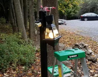

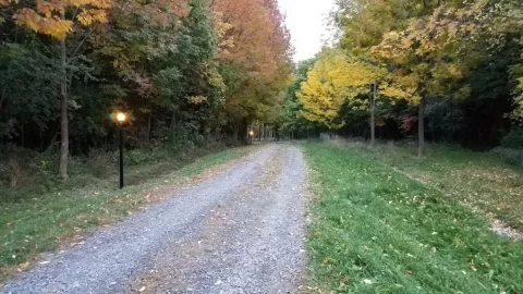

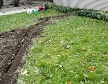

Ok...it was a rough weekend with weather and lots of work was accomplished with the help of an equally hard working friend.
I decided to go with 12/3 wire so that I could keep the outlets at each pole separate from the power to the post light itself. This is so I can have Christmas lights on wrapped around the posts, and not have the post lights on themselves. They came out nice and all that is left to do is to fill the trenches back in and tap down. I used a short run of cpvc and 90 degree angle in and out of the pole base. I did this to keep the wire out of the cement.
I used rocks to stabilize the pole and keep it level, then poured half a bag of quikcrete in on top of the rocks. This filled the hole about half way. The rest we packed with clay soil.
I'm very happy with how it came out. Wife and I walked around last night up our driveway, for the first time without flashlights. :)
