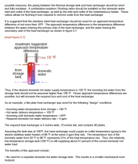

Here is a system I have been trying this summer. With 5 collectors in a drainback I can keep about 150 gallons of my system around 160- 170 in the summer, easily. In the winter it will be heated by solar and wood. So far I have not need to supplement the DHW this system produces.
Basically when any hot water faucet is turned on a Sika flow switch turns on a small circ to circulate the DB water thru the A side of the HX. The cold well water flows thru the other side and is heated instantly. It takes about 5 seconds to get up to temperature after the faucet is opened.
The next Caleffi I-dronics 11 will be on DHW, here is a preview of some of the concepts.
The 5X12- 30 HX is exactly what I used on mine and it supplies 3 GPM non stop, easily.
The main goal it to not have to store DHW, and eliminate the possibility of Legionella potential in a DHW tank that falls below 120F.
There are codes in Europe that regulate DHW production. Most folks have tankless. If a tank style DHW is used, it must be elevated every 24 hours to 60C (140F) for 60 minutes.

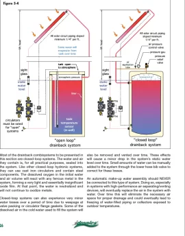

I like the drainback for it's simplicity. I prefer water as the transfer medium compared to expensive, maintenance prone glycol. Yes the same water circulates thru the collector, storage, wood boiler and radiant heat loops. the only exchanger is for the domestic water.
A closed loop with glycol and a pv powered pump is a good choice. Not many larger sized DC pumps available at an affordable price, so depending on the size of your array that is a concern. Every heat exchanger you add reduces efficiency and costs an extra pump and power to run it.
In it's simplistict form it starts like this. Adding heating zones and mixed temperature and DHW adds components and piping. In this case it is a pressurize drainback. the expansion "tank" is the air bubble trapped at the top of the tank.

Wouldn't that be technically an open system with air in the tank? Disolved oxygen and all? I do like the simplicity! But I was alswys told air in any closed system will disolve in the liquid and cause corrosion problems, have I been miss led? I would certainly like to do this with the DHW going directly to the collectors via a bronze pump, than piped back to the big indirect w/o and heat exchangers. I'll just keep the bottom coil of my indirect connected to the wood system. And only the BTUs needed to bring it up to 140::F (if any) to avoid legionella would need to come from wood or another source. The caleffi Idronics has provided to be excellent sources of information and piping arrangements. I look forward to reading and studying it when it comes out.
I am going to leave a couple of stubs for future use on the tops of my stacked horizontal tanks when I put them in. I like the idea of a future simple direct hook up from there to solar panels - but was thinking I'd need a HX and separate (maybe glycol) loop for the panels on the other side.
Is that pressurized drainback setup you're talking about a commercial unit? Would you have a link? I don't have much solar knowledge, but was under the impression drain backs were open systems, therefore require a HX.
The water in a closed loop solar is the same as in a hydronic system, it becomes 'dead" water so to speak, once the O2 is depleted. The small amount of O2 will oxidize on the plain steel surfaces and provide a small protection layer. Early hydronic systems had plain steel expansion tanks, no bladder. Typically those tanks hung above the boiler between the floor joists. Those tanks lasted for many years, so say longer than the modern bladder style tanks :)
One issue with a direct system where the potable water circulates thru the collector is scale build up. As you add new, fresh water you add minerals, calcium, whatever is in your water. A very thin scale deposit causes a large amount of the heat transfer efficiency. So a closed loop with plain water is just fine. No need to use a bronze or stainless pump on a closed system.
Direct systems with tank and collector are very common in warm climates where there is no freeze potential. They are fairly in-expensive and have a life cycle like a ttypical water heater 5- 10 years, then they replace the whole system.
I have plenty of friends with close loop drainbacks and 20 plus years of service. one in upstate NY has 27 years on a plain steel tank in a drainback with air bubble.

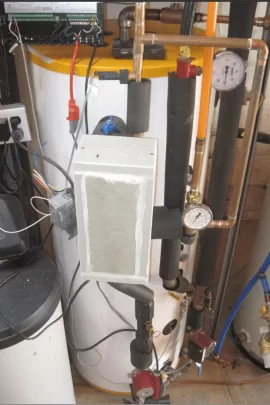

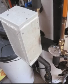

It's a little rough looking I'm about ready to upgrade the tank. A homemade insulation jacket for the plate HX, water softener to the left.

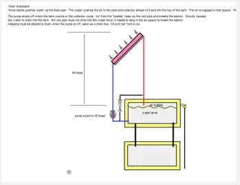

If one had two stacked horizontal propane tanks in their current system, with extra fittings & stubs piped into the top of each one for future use (what I'm planning with 330 gal. tanks), they could plumb solar panels directly to those in a pressurized drainback scenario? In doing that, the panels would draw from the top of the bottom tank, and return to the top of the top tank. That is, in non-heating season, and when the panels are doing their thing, it would effectively halve the storage being used from 660 to 330 - much more suitable I would think for a solar DHW application. I just haven't got my head around how the air return tube setup actually funtions and allows the panels to drain back, and how the water & air move back & forth on drain back. Could that air return tube, rather than being plumbed to an air space in the top of the storage tank, be plumbed to the top of a non-diaphragm system expansion tank (110 gal.), the top of which sits lower that the top of the storage tanks? I'm picturing the air space in the expansion tank filling with water over time doing that - but that's without a good understanding of the forces at work here.
I'm finding this all very interesting.
The air space you allow in the top of the upper tank becomes the expansion space for the entire system, solar, wood boiler, piping, etc. So leave the equivelent of what you have in the size of your current expansion tank. So fill the upper tank to within maybe 12" of the top. A sight tube made from clear pex tube, shows where that level is.
I never use an air tube, the pipe coming down from the collector stops just into the tank so it has access to that air bubble. When the pump stops, air rises up and breaks the siphon.
like turning a gas can over and trying to pour gas without allowing air up into the tank, same concept. So 280 gallons into the tank allows about 50 gallon of expansion "tank" trapped inside. You may need to add some air over the years as some will re-absorb into the fluid. A simple air hose fitting works fine for adding air.

In my case, I'm pretty limited on storage space - so would not really be wanting to give any of it up to the air bubble. Plus, my heat loads are going to be pulled from the top of storage, where the air bubble would now reside. After seeing that air tube in a couple of the diagrams, that's why I was wondering about being able to utilize a non-diaphragm expansion tank if ones system had one, and if the height of the top of expansion relative to the height of top of storage would be a determining factor in that. Maybe one could shoehorn/plumb in another small tank on top of storage for the 'air bubble' section? Guess I should do more reading - those idronics references are loaded with info.
Can you locate that expansion tank above the top storage. it would act as the drainback tank and the expansion air space.
I've gone thru things in my head over & over the past few months, and have no place above to fit an expansion tank - although I might end up with a foot or so of headroom between the top of my insulated tanks & the bottom of my floor joists. That's why I was wondering about putting something small up there for a drainback tank, along with my main expansion tank on the floor under the stairs.
I'm pretty sure it wouldn't go over too well if I proceeded to try to put the expansion tank in our living room or a bed room.
