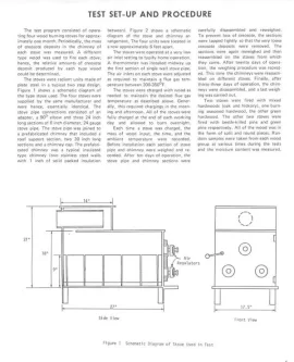

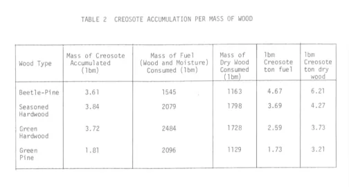

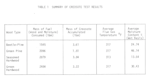

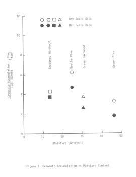

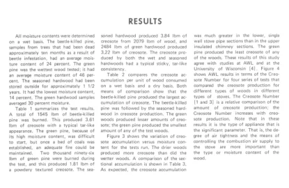

In the case of the creosote studies, these guys were using the same techniques that the EPA used to develop the stove testing protocols. If you doubt their results, you really need to question some stove maker doing the same thing in New Hampshire, using the same type of equipment. Data is data. Interpreting that data is a different story. In the cases I have brought up, the only way to doubt the findings is to doubt the methods used to obtain them. Again, the same methods used throughout the stove industry since well before the first EPA regs went into place.
The following is from yet another study (Georgia Forestry Commission), this one simply to determine the amount of creosote produced by burning beetle-killed pine compared to seasoned hardwood, green hardwood, and green pine. I only have this in PDF format on my computer, so I can't provide a direct link, but these screen captures effectively show both their test procedure and the results. Nothing to interpret here, this is just four air-tight stoves (who can identify them?) burning about a ton of wood over a 33-day time span. No raging fires or wide open air needed. Flue temps in all four stoves were controlled to attain flue temps between 300-350ºF throughout the course of the study. The creosote accumulation was periodically weighed, so unless they didn't even know how to use a scale, you can't really find reason to dispute the weights. Sadly for our fellow beetle-killed pine burners, in this study the beetle-killed wood produced the most creosote of all, while the green pine produced the least.
So, I guess because science can never prove anything, we should feel free to completely ignore these studies, is that the gist of what you are saying here? Continue to get our wood drier and drier until someday science finds a way to prove it is incorrect to do so.... which of course, it can't do or it wouldn't be real science, is that right? Talk about yer classic "Catch-22" situation.

Agian, I don't see a lot of issues on this forum with people complaining about their wood being too dry. The vast majority of the issues are with dry wood. Some people remark about overly hot burns, which could contribute to very dry wood, but it is a rare occurrence. You seem to be arguing with yourself on this as most people on this forum shoot for 15%-20% which is in line with your comments.
And your statistics claiming that wet pine produces less creosote than certain overly-dry wood is all well and fine, but burning wet wood is a pain in the butt. I don't care if wet wood produces gold plated fairy dust. It is annoying to heat with. I am pretty sure you and every one else would rather have the issue of a fire that is too hot than a fire that simmers and does not produce much heat.
If I'm arguing with myself, why are you and so many others contributing to this thread? The thread is asking if firewood can be too dry. Start another thread if you have nothing useful to contribute to this one.
And it ain't my data (statistics?), I'm just copying it for others to draw conclusions from if they wish. Regarding wet wood, I've burned plenty of it in the past, and have gotten huge amounts of heat from it. You have to know how to do it is all. PITA? Of course, I'm not recommending it here, nor have I ever at any time. Simmering, smoky burns and no heat output simply means you don't know how to do it right. The authors of the report that:
"The green pine, because of its high moisture content [46.14% wet-basis, 86.67% dry-basis], was difficult to start, but once an adequate bed of coals was established, an adequate fire could be maintained."
What's "an adequate fire"? Well, they were able to maintain an average flue temp of 317ºF with the stuff. That sounds like a pretty normal burn to me.
They also reported that the green pine produced creosote "of a powdery texture", while "the creosote produced by both the wet and seasoned hardwoods had a typical sticky, tar-like consistency".
Which type would you rather find in your flue pipe?
