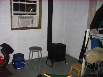

O.k., here goes!
It's working like a charm. High today was about 36, dropping to 27F tonight. Resolute has been burning all day in the house. It's a comfortable 71F and the heater hasn't kicked on other than first thing this morning.
The Intrepid served me very well today. I had to work on my Westfalia. So nice to use the creeper under the bus and be comfortable doing it.

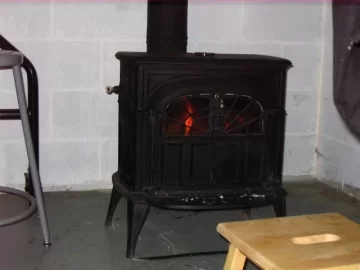

Here's another shot

include pic of vw please!!! and hey jeesum crow take that ac out of the window!! LMAO

AC unit coming out soon. To be bagged on put in the basement. It's a good little unit, but the ceiling fans (cheap Chinese Hunters) do the job winter and summer.
Perhaps you can correct me if I'm wrong (which I frequently am), but it's my understanding that generally even in those jurisdictions which actually allow a solid fuel-burning appliance in a garage (or anyplace where there may be flammable/explosive vapors present), they at least require the appliance to be mounted 18" above the floor. Is this not the case where you live? Always looking to learn. About thirty years ago, when I lived in Albuquerque, there was an article in the paper that I've never forgotten, because I'm an inveterate car & bike guy. A guy there lost two pretty much priceless classic autos...one Rolls-Royce, one Mercedes-Benz (both ~1920's), because he was working on one of them in winter and it leaked gasoline, and the pilot light from his water heater in the garage ignited it, and everything...cars, garage, and most of his house, went up in flames. I remember that I got tears in my eyes when I read that article. Please be careful. Rick
Thanks for your concern.
It's not illegal in our area, not even addressed in local laws. Such is what you get living in Appalachia.
I've taken great care in making sure there's nothing combustible near, and all the bikes and cars are fuel tight. I "down" the stove after every use and make sure it's buttoned up tight.
If fact, I only bring in the wood I burn (happily, it doesn't take much to knock the chill off the garage), and empty the ash pan after each firing.
By and large, I would say it's much safer than the propane space I used the last two years. Pretty useless, I might add.

I was just going to inquire about code compliance myself Rick, not to be a spoil sport. It does look nice and seems reasonable on the surface but Fossil asks legitimate questions with the ultimate reson in mind, personal safety, not to mention the bikes, v-dub, etc.
Nice. I just inquired with my insurance agent about putting my old Garrison stove in the garage. She said that State Farm would cancel our policy if they found out! The reason is along the lines of fossil's story - apparently too many people burn their places down...
I'm jealous you can have a stove in your garage!

So the issue reall is the vaporization of fuel - IE bring in a cold car to work on it, the gasoline expands in the tank and the vapor pressure increases and it vented out - especially in older cars with less emmisions controls and with a less "closed loop" fuel system. I have a friend with a race shop that had the shop go up in flames from a kerosene heater and a fuel cell that was had been brought in the day before just from vaporizing.
I though this was addressed in the NFPA code somewhere, not sure if it is in 211, but I know NFPA states no solid fuel appliances in a garage.
In the last year I can think of at least two fires caused by wood stoves and fuel vapors just in the small area around where I live.
Please be careful, I would highly advise never using it when a vehicle is in the garage... sorry to be a party pooper.
NFPA 211 - 12.2.3 & 12.2.4 This standard is not law. The local Authority Having Jurisdiction can choose to adopt the standard or not. Most do. Rick
