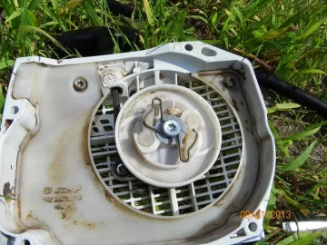

After running the 660 in some wet pine (rooster tail wet) I let it idle then I shut it down, the dogs would not engage when I went to start it again so I went back to the 390.
When I finally got home I took it apart to dry, after letting it dry I hit it with air. It seems like it works good after that but the clip looks like it's broke on the right side.
  • Is the clip broke?
looks more like a chunk of something there binding the dogs from swinging out
It did have some fine chips (dust like) from milling, so when it got wet maybe it change to a paste which stopped the dogs from engaging.
