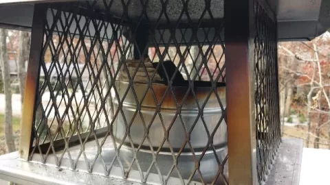

    I had a Jotul c450 insert installed a few weeks ago. I got up on the roof to check out the install and noticed that the insulated liner was not cut off evenly at the chimney cap. Will this cause a problem?

    Sloppy, but not enough to classify the install as "bad"
    I wouldn't think it would cause a problem...

    That really sucks. Why cant folks just take the extra time to do a good job of something? Can you notice it from the ground?

    I would send that picture to whoever installed it and complain.

    Perhaps prevailing winds come from the direction of the taller side and they did it to improve the draft. ;lol
    Or they're just hacks....

    I can't notice it from the ground I didn't notice it till I got on the roof. We really don't have a prevailing wind here. Besides the way it is it would catch a northern wind, when I need a fire the most. I may trim it back myself, then I would know it was done correct.

    I would take a close look to make sure the clamp assembly is catching the entire liner and not just the top part showing in the photo. If you don't have a solid connection up top the flex liner could work loose and slide down inside your chimney if there is any tension on the liner. When I installed my liner I made my bottom connection to my stove first and then went on the roof and pulled the slack out of the liner so that it would have some tension on it making it stand up straight and not lean against the sides of the clay tile liner of my chimney. If your flex liner is installed in a similar manner you wouldn't want the top connection to slip loose.

    That was cut that way on purpose, flex is a pain to cut without having the right tools, that is not a mangled looking cut. I would call the installer and ask why it was done that way, might be a reason to it. It won't hurt anything being that way.

    Just trim it off.
    Personally, I would be more concerned with whatever else they did half assed.

    its hard to find people who take pride in there work ,does it hurt anything ..no but thats not the point .if your gonna do something do it right .

    I still say it was purposely cut that way, not a cut rate install. They cut across the ribs which takes quite a bit of pressure and a good sharp blade, looks to me like there is a method to this madness.
