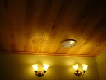

I used Fantech inline fans and have been nothing but highly pleased- they can move a LOT of air with so little noise you may forget to turn them off- quality is in a different universe than the tinny noisy builder-grade/ Homecheapo bath fans. I mounted both fans in the attic and used 4 inch PVC for a vertical run through wall cavities from the first floor bath to the attic- easier and more robust than ductwork. Fantech also makes tasteful understated grilles. HVACquick.com [or something like that] was an excellent source not only for the fans and grilles, but also for the flexible insulated ducting that I used between the fans and the outlet fittings that went out through the gable end attic wall- low prices, big in-stock inventory, modest shipping cost, and quick arrival for stuff.
