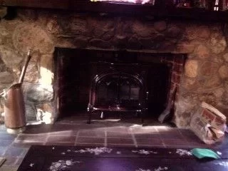

Does anyone know what the exact temperature start range is for a stove to be considered "over fire"
And what is the ideal temp to keep the stove at for most efficiency and heat output? My manual is rather vague on both subject.Thanks for all the advice...VERY MUCH APPRECIATED

looking that the first picture mounted within the fire place opening,I have one additional observation. Free standing stoves are designed to be in open spaces
allowing free air flow around all sides of the stove pluss the brick absorbing heat and radiating it out does not seem to me an ideal setup for a free standing stove design.
let me review a personal experience with one of my computers. It was situated in a compartment in a computer desk after a while I get all kinds of error messages and it locks up I plug in my post diagnostic board and it tells me the processor is bad. but next day it runs fine for about 1/2 hour again the same pile of error messages and it freezes so I replace the processor A little time goes by and the same thing happens finally i replace the processor again but this time I remove it from the enclosed cabinet in the computer desk I never suffered problems again. The confined space did not allow enough free flowing air space. Apply this to you confined location of your stove. Did anyone think that confining air space around a stove limits reducing heat dissipation?
so what temps should you run your stove in that location I can't tell you but My guess it should run on the lower end . 750 in that location might just ruin your stove. I don't know what parameter to tell you, for a stove designed to be free standing?
Is that an appropriate analogy? A computer -requires- the rapid dissipation of heat away from sensitive components in order to function. This is not true of a wood stove. A wood stove actually performs better at high temps and is not threatened by staying at design temps. The effect of heat on electronics is not at all the same as heat on cast iron.
The Firelight is a close clearance stove. I can't be sure by the image but it looks like it has about 2.5x the required side clearances. As long as the stove is operated in it's designed temperature range, I don't think it's more threatened by being in the fireplace. This type of installation is quite common, especially in Europe.

Begree almost all inserts have an outer convection jacket made to dissipate heat in a confined area, some coupled with blowers. I don't know if my analogy was appropriate. I was making an observation. wondering if the one pictured has enough free flowing air around it to dissipate heat? I said I was not sure.

Elk, drop over to Jotul UK. Take a look at the installations pictured of the F400 or MF3. This is a common application for Jotuls. The non-box stoves run cooler at the back and sides than some stove. From what I can see of sabastio's installation, it looks like there is very generous clearance around it.
