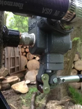

    Could you get a close-up photo of the little casting on the end of the valve body, where the control lever is attached? Mine was loose when I got it, and when I went to snug it up, I noticed it's bent / bowed. Only a few hours use on it, but TSC doesn't want it back, so I need to set up an appt. with the local Speeco service shop. Meh...

    Here's what I'm talking about:
    Note gap on left side, above chain links. Leaks a big from this gap.

    Did you try to install a second gasket on top of the first? You know twice as thick.

    I didn't install anything. These come pre-assembled. That said, I don't see any gasket in there.
