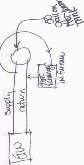

I have drawn out what i think the other installer was trying to get across to me i want to put a 40 plate flat plate to heat dhw just not sure what to do with everything else any help would greatly be appreciated. sincerely Doc

I don't know anything about your specific situation and I have no experience with OWBs, but 300,000 BTU/hr seems very unlikely in Kentucky.
Just for comparison, my heat load for a 3500 square foot house at 20 degrees below zero is 30,000 BTU/hr. Unless Kentucky is a LOT colder than that, or unless your wall are made of tissue paper, I doubt that you'd use ten time the heat that I do.
It's fair to say that most boilers can't sustain their rated output for extended periods in the real world. My 80,000 BTU boiler actually averages more like 65,000 BTU/hr.
A 50 gallon tank doesn't store much heat energy at all. Even a 100,000 BTU/hr boiler would raise it from 60 to 180 degrees in half an hour. It might be helpful for extending your domestic hot water, but not as heat storage for space heating.
I haven't been with this forum for very long but I have found there are some very knowledgeable people who are members. From what I have seen 400 gallon storage tanks are considered small. 50 gallons would only be like a hot water heater and not much of a "battery" of hot water supply. There are pressurized and open style storage tanks. Do some snooping on the net before you take the advice of the people you have quoted. Google "outside wood boilers" and compare their rated out put to oil, gas or electric boilers or furnaces. Try cozyheat.net and see what they have to offer. I purchased an EKO 40 from them and it is rated to heat a reasonably insulated home of 4000 sq ft. Check the kwh rating of the unit you have, or have been advised to purchase, compared to those and others you find through your google search. The numbers you find should tell you what you need to know. Cave2k
something don't sound right. As nofossil pointed out.--- My situation, I have a 1800 sq/ft house, plus a full basement. So figure 2700 sq/ft,+/-. Approx 10yrs old. I am able to heat this with an 85,000btu oil fired furnace. I am putting in a tarm solo 30, rated at about 100,000btu's. I am in northern maine, had 4 good frosts already. You're in Ky. Again, something don't sound right.
