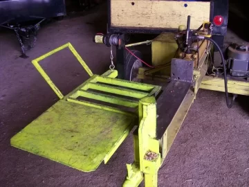

I am having a welder make a table for my 27t craftsman splitter. I am looking for pictures of tables others have made. Any ideas, or things that you would change about your designs? Thanks
I welded a pipe on one side to hold a patio umbrella, and bolted a plate on the outside to hold a vice for holding a saw. both are handy.
Mine is designed as a lift/table. Like this:
Log Splitter Table Pics
