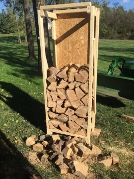

Here’s the Ashful wood-shortening apparatus rev.a undergoing initial testing. I built this when I installed my Ashfords in 2015, and built a bigger better rev.b in 2016. They only take an hour (or less) to knock together, and it allows me to cut about 1/6th of a cord from Jotul 600 down to Ashford 30 length, in a single pass of my big saw.
Note those chunks on the ground... I have a love/hate relationship, with those thousands of chunks it generates.

Real nice, Ash. I think there is a powerful metaphor for life in this.

Ashful, I was just going to suggest what you have built. I can take a picture of mine, but picture this: Build this frame or raise yours up 14" or so. That way you can slide a box, tote, or milk crate next to it to catch the "heat chunks". Saves one more step.

Nice build. I wouldn't be surprised to see a caped superhero fly out of that.
What a great idea. Simple and elegant.

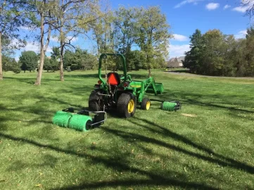

I pick up walnuts off the lawn every fall, and hated the back breaking job. Ran across one of those "picker uppers" and don't have to bend over to snatch them up. Now it's just a few walks around the yard with a bucket.
Next step- place a conveyor to catch the chunks and feed right into the stove.
I have a rig for that, too, Ed!
Think driving range golf ball picker, and you have the idea on how they work. One in front to get right around structures and trees, one behind for the rest. Might move the trailing one to belly mower location, someday.
On the wood shortening rig, catching the offcuts in the tub would eliminate that chance of separating them from the pounds of saw chips this process generates, although I guess we could find a way to manage that, too. Do not under-estimate how much chip you’ll generate when cutting down a full cord or two at a time!

Your nut cleaner is awesome. Love it!
I picked up a used lawn sweeper late summer with the idea that it might work when dragged behind the old Wheel Horse to clean the nuts, but it needs some work, and when the temporary flash of common sense hit me, and I figured out to use the picker upper, I put off fixing the lawn sweeper. I figure it might take me 30 minutes to fix the sweeper, and it would probably have saved me a couple of hours of manual labor, so you can see the flash of common sense was temporary. Another "next year" project.
