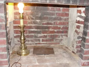

I'm assuming you started with something like this
Looking to Install a Wood Burning Stove Insert in old Fireplace.  Need advice!
Jeez if that doesn't look familiar! It is EXACTLY the same fireplace. I just got home and got some pictures. Lets see if I can get them posted on here...
1) Looking through the front of the fireplace
2) Looking up the fireplace

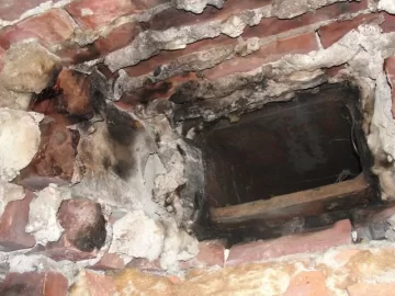

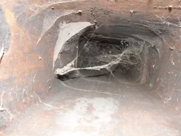

3) Looking up the flue (Looks like it could use a good cleaning...)

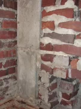

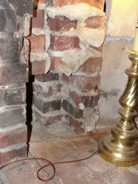

4) Right side of the fireplace interior (the "white blocks")

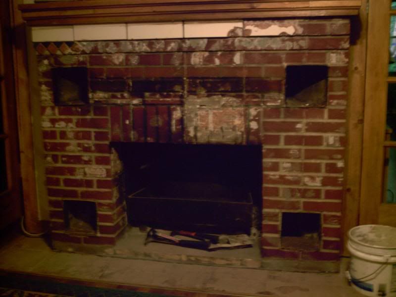

5) Left side of the fireplace interior showing the exposed (lower) heatilator vent.
If you need to see any other pictures let me know! I really appreciate all your help. Thanks in advance.

Hey Dixie, I just realized you're in Ridge! I'm also a Long Islander. Born and raised. Live in Shirley and work at Stony Brook University. I wonder if the same person built both of these fireplaces. The resemblance is downright scary!
Sounds like you guys are okay. Your new stainless liner will satisfy the liner requirements. The damper plate mentioned in the installation is NOT the old damper you cut out. It seals around the new liner right about where the old damper was. You're going to LOVE having an insert. You'll forget about the cost once you see how well it heats your house!

I'm not a masonary expert by any means, but the 5th pic makes me uneasy. But, that could be due to taking out the metal tubing for the heatilator system.. I'm sure one of the guys will chime in here about that issue.
I CAN tell you that the heatilator system is an awesome thing to have with an insert, especially when the power goes out. Mine still works with the insert installed, and it's a HUGE help if there is no power. You won't freeze, even if your fan can't run.

Hmm, what about the 5th pic is unusual? I wonder if the design of the heatilator changed over the years because I don't remember any metal tubing in the heatilator ducts. What did they look like? Each of the four vents was mortar and brick behind the grate from the start (I know because I removed them to clean out some cobwebs when we moved in).

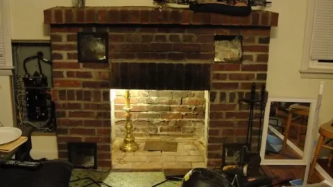

Refinished FP with insert, Murphy not included ;)
