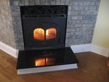

Could you post a pic of your hearth? If you have to extend the hearth anyway, then I'd go for a freestanding hearth stove. In your case, I'd probably be looking at the Oslo or Fireview. If your going to go with an insert, get the biggest you can fit. The Regency is a very good stove and would serve you well. I think a Blaze King Princess might fit your fireplace. If so, I would give this some very strong consideration as well.
I usually keep my firewood in that space to the right, which would be a problem for the sideloading Fireview.

Downstate NY, 2 story Victorian. FP is in center of house, in open/merged LR/DR. Den, stairwell, and kitchen come off this room. Back surface of brick FP is drywalled.
Perhaps it would be possible to retrofit a blower in the space between the insert and the top of the FP opening. It's nearly 6" tall. There are 1/2" gaps on both sides and the bottom of the insert that could feed air to fans on top blowing out.
I'd still lean towards the Fireview. I think you can order the door on either side. I believe they still have the sale price too. If you're going to do an insert, then I think that Regency would do a good job.

Are you planning on removing the raised hearth? What is the height of the fireplace measured from the floor? There may also be other options for rear-vented stoves albeit non-catalytic ones e. g. from Jotul, Hearthstone and Quadrafire. For any stove you will need to check the side clearance to the wall on the right side. I also don't like how close the floor trim is to the fireplace. You may want to remove that, too, while doing some changes to your fireplace.
