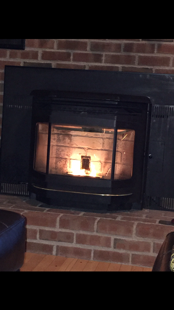

Hi guys, ive been doing a lot of reading on this one and so far i cant figure this one out.

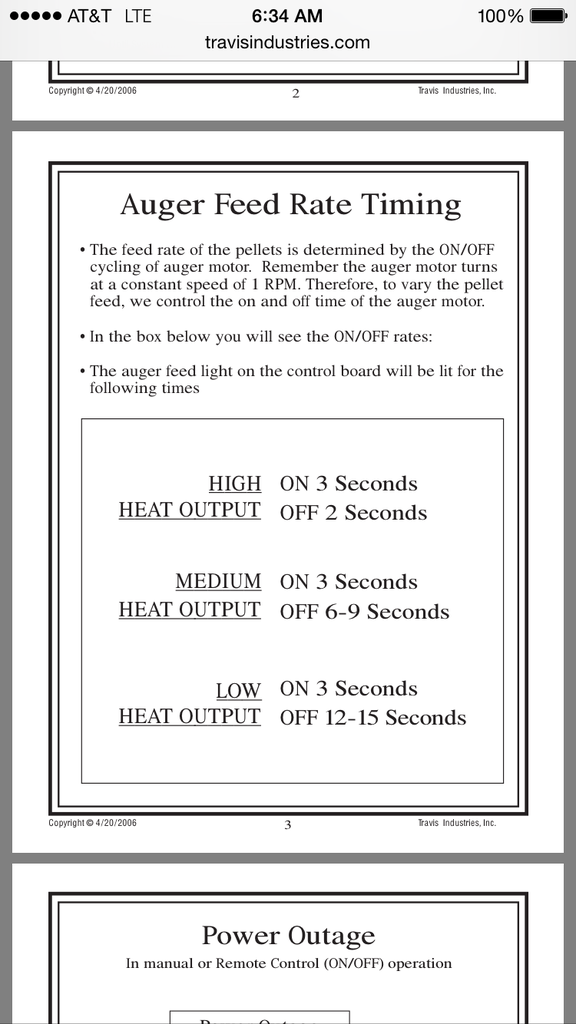

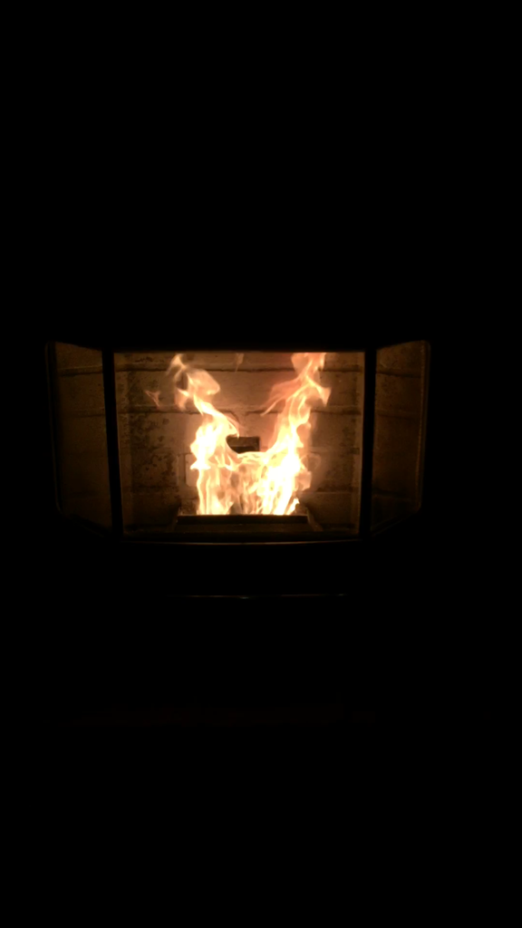

My 2005 astoria bay insert was working great for the last few months. I clean it at least once a week though just to keep on on it. Ive tried many different pellet brands and the problem started right when i bought a ton of the hammers hot ones. A few times i got a lower than normal flame. Almost where it was down deep inside the pot, then after a few min it would roar back up to a good tall lively flame. So i dealt with it for about a week before i had a chance to really explore it further. I pulled the stove out and removed the exhaust and was surprised to see it totally full of ass to the top of the outlet! So i was 99% sure i would clean it out and solve the problem. So I removed the combustion blower and the whole housing was full of ash and so was the fan blades pretty much chopping through it. so I've vacuumed everything out spotless and got all the passages that go through there to the inside of the stove. I also did the leaf blower trick and made sure that the whole 4 inch stainless pipe was free and clear of any ash. I then re-assembled everything and started the stove and it seemed to be fine during start up but then about 15 minutes later it was doing the same thing. I also tried a different type of palettes that I know always worked well and still had the exact problem. It's been doing this for a few weeks now maybe almost a month. I'm curious if the exhaust blower or combustion motor is weak or on its way out due to that ash buildup that was in the housing. But then again as I'm watching it it appears that there are not enough pellets going into the burn pot. So I took apart the auger flight tube cover to check for any buildup or clogs and found none. So im torn between putting a new Auger motor in it or replacing the combustion blower. I really don't think that it's a control board problem because the auger timing seems correct according to the light and it starts up fine and turns the blowers on at the right time. Im stumped on this one. The stove ran great when i first installed it so its not a anything like a oak issue or somthing simple. Any ideas??
