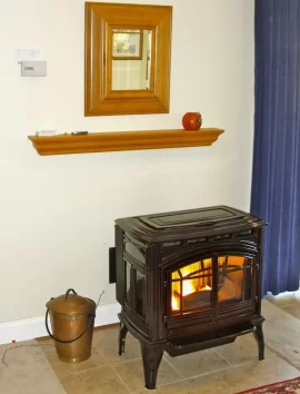

Thanks for the comments. Did notice in the manual references to the exterior getting hot but was surprised on just how hot it got, especially compared to the old Mt. Vernon which stayed cool on the top and sides. Been running for 4 days now and it's incredible how much heat the unit puts out. The fan doesn't appear to be as powerful as the Mt. Vernon but it seems to put out more heat overall. Still need to connect the programmable thermostat and then should be good to go. Attached is a photo to show the install did actually happen......

Looks great Mark! Thanks for the pic, and enjoy the heat!
