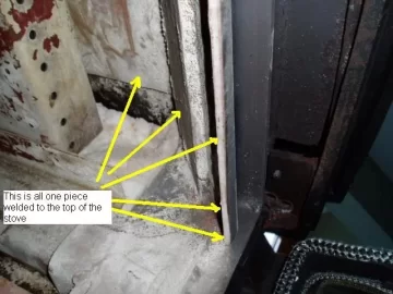

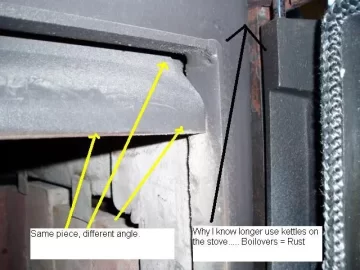

Pics with highlights, the piece is INSIDE the stove....
Thanks for the pics, Madison.
That piece looks o.k. I can't really see a weld up inside the firebox, though. I can see one all the way across and on the sides when the door is opened up, but on the inside I can't see up in there. I put my fingertips up around the piece, from the inside, and it definitely feels connected to the stove...
Yea that is the only piece I can think of that is welded, and could be called an air deflector. And IF, big if, that is the piece in question, like begreen suggested, fire that puppy up.

I tried calling the retailer just to see if they had record of the whole "fix air deflector weld" message or at least to point me in the direction to looking for it myself, and they said they don't service the general public -- I have to go through the chimney co. that bought the stove from them for me.
So I will try to do that, I guess. The only problem is that the chimney co. did me a favor by getting the stove at their cost and even had their guys bring it down to the basement. They didn't make a dime off of it, so I hate to now call them and ask them to call the dealer and figure this all out. That's why i was hoping that it was an obvious weld to an obvious part in an obvious area that I could check!!
I'm still going to fire this puppy up, as soon as its piped in!!

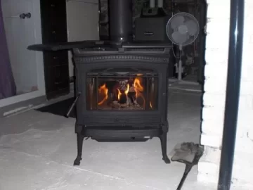

Here's some pics as promised. This is my fourth, and final, break in fire. Just trying to get the smell out. Getting better. Also getting familiar of the workings of the stove. These pics are after a 4 split load, soon after start up. Stove top temp was 550 at the time of pic, air shut down all the way. Now settled right in at 600-625ish. Have to say that I LOVE THIS THING!!

Awesome. How are the temps in the cave?
In general, pretty good. It doesn't seem to get "cold" down here (below 60*) until sometime in late November. But once it does get cold down here, it stays cold until mid April!!
The Cave started the night at 63*, and now 2 hrs into the fire, its at 73*. Even better, I opened my basement door, leading to the dining room upstairs (where the thermostat is) and noticed that the thermostat is two degrees higher than what I have it set at. That's a welcome feature!!!
Did just notice that the stove top went up a bit to 650. Hoping it settles in there, as any higher I'll get a tad nervous!!!
It'll be fine, even at 750. By mid-winter you will be taking it up to 700 pretty regularly until you have a chance to get some insulation on those walls.

Well, that's good to know, because I was wondering what would happen if I loaded it with, say 5 splits instead of the four I did tonight! I'll put more wood in it on reloads in the winter, that's for sure.
From behind the view where the pic was taken of the stove are sheetrocked and insulated walls. But the area to the left and behind the stove are my stone foundation. That is whats new this year for the room. Previous years, with the 602, it was one big open space!!
