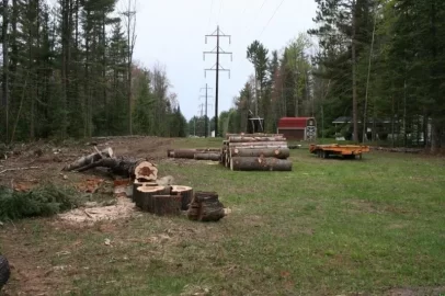

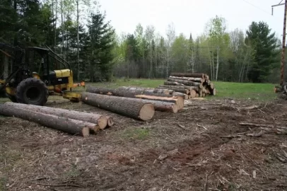

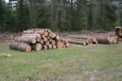

This is the staging portion....collecting all the logs the tree co. took down. Mixture of Red Pine, Spruce, and White Pine.
There were also a very few Maple which were turned into firewood. :coolsmile:

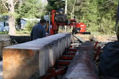

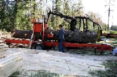

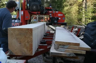

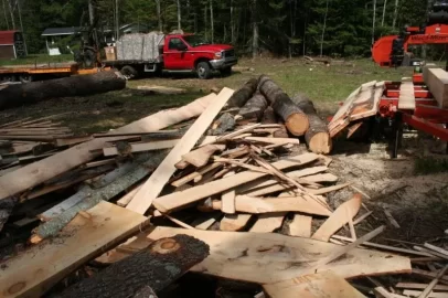

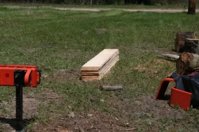

Here's Don sizing up the first cut (I think it was the first).

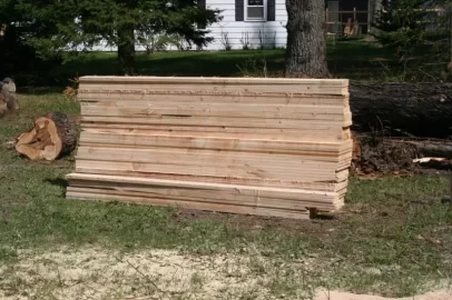

First few boards.

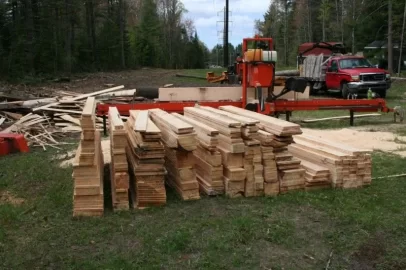

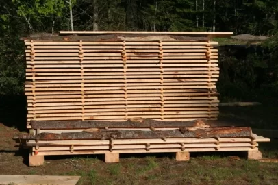

The stack getting a little bigger.
My job was to offload the slabs and boards. Toward the end, we got into some LONG logs, and Don had to help with some.

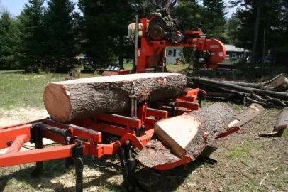

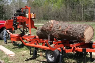

Only problem I saw was when the blade hit a knot, it wanted to deflect a little. Tension? Dulling blade?
This was the biggest log we put on the saw. I think it was a 30" W. pine, and the blade just got through the end. Pretty much maxed out on the length, which was about 20'....I think.

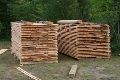

Sweet pics Dave and nice lumber, thanks for sharing.
I really enjoyed doing that, but next time would prefer to do it at my own pace. This guy wanted to work ALL day. I didn't.......but did as long as he was here.
An Alaskan mill would be nice to have and would work well with the saw and softwoods here. I'd need a better saw for the oak.
I'm sure this is old hat to some guys on here.

That's one problem with a BSM its not rigid like a saw blade. The deflections get worse as the blade gets dull. But some blades are better at handling it than others. Woodmizer has a large selection of blades, hook angles, thicknesses, and withs. But I haven't gotten them figured out yet. I really need to go down and take one of the owner classes so I can ask questions about it now that I have ran one and know what questions to ask. As I started with with what my Uncle thought he knew but obviously didn't know. And I learned more reading the manual than from him. I also learned a lot from people in the area that have one but none of them had the class either as they bought there's used. When I got the mill back from my Uncle I got a new 4 deg hook blade and it deflected quite a bit. When I ordered new blades last fall. I told them what I was cutting with it and they sent me a 10 deg hook. And I looked up there part # on the blade and it looked like they sent me blades for soft green wood and I though I was going to have to send them back. But I was quite impressed and it did a lot better than the 4 deg hook.
Woodmizer says it will cut 21' long logs. But it was tight getting 20' logs on mine. But they do make bed extensions to let you cut longer logs.
