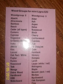

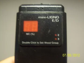

Does your meter have 2 wood groups ? If so be sure to get the right one. Those that don't probably are not to accurate. Either way should give you an idea.
2 wood groups? As in softwood and hardwood? Please explain, Im not sure I understand the how different types of wood would read different on a moisture meter. Thanks
100_7068.JPG100_7063.JPG Don't know the science behind it but when I don't have the meter on the right group the reading is way off.
Ramin, Rosewood, Teak, Wenge? What do you guys smoke down there? :p
Wow I would have never known that there is a difference
I'm guessing it has something to due with growth pattern and cell structure, sorry it the biologist in me;) I've read that under the right conditions Oak with put two rings on a year.
Referring to the Woodmasters pic of his moisture meter, it's interesting that they use the common names for wood species to be tested, not the scientific names. I'm reading the Peter field guide: 'Eastern Trees'. It seems a common name can apply to different species and different common names can apply to a single species.
