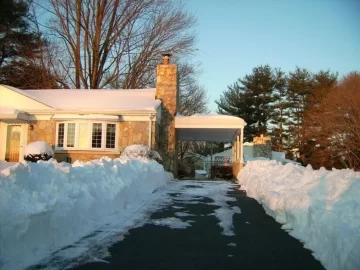

    My antenna has been strapped to my chimney for seven years, no problems yet.

  10. Your chimney could support on of those late 80's satellite dishes no problem.
    firebroad likes this.

    yeah, but he's talking about strapping it to a stainless steel run, not some masonry chimney.
