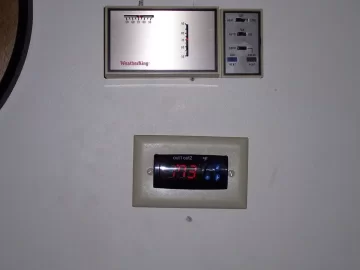

Here's my latest toy for the biomass. This is a Dwyer TSS2 temperature control with a TS-1 probe in an aquastat well placed in a 2" tee off the supply line. I have this in my living room so I don't have to go out and see what the boiler temp is. The boiler is 80' from the house. This is a 24 volt control and I ran it through some of the not used 18-8 thermostat wire I have going out. This control also runs my dump zone and I have it hooked up to a radio in my bedroom to wake me up if it gets below 160 degrees. It also has built-in alarms to set in the control itself.
