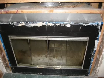

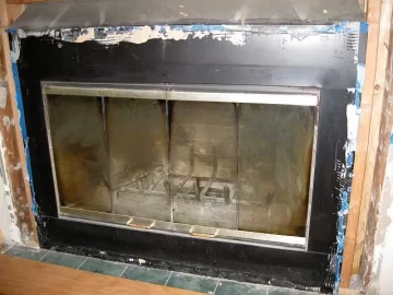

    Hello all, just found this forum and am hoping to find some info on my current situation. I bought a house a little over a year ago (1974 split level about 1600 sqft). Ive got a older quadrafire 1000 downstairs that does really good for keeping that place warm.
    The question I am looking into is I have a old insert upstairs. From what I can tell it is a MHSC SB38 or similar type setup. The piping is 11CF (thats what it says on the side). I would like to replace this with either a wood burning insert (the type with a fan and what not) or make the current insert area into a alcove of sorts and put a small free standing wood stove in there.
    From what I gather I will have to replace the piping no matter which route I go correct me if I am wrong. Unless I go with a pellet stove insert which may or may not be able to use the current piping.
    Going with a alcove type setup would require a major overall. From your guys's experience how much of a pain is this in all actuallity if I am replacing the piping anyways. I am ok at tearing stuff apart and rebuilding things, not the best but I do all my own remodeling. Just never played with fireplaces before.
    Thanks for any input on this subject.

    Welcome quint. That would be a zero-clearance fireplace, not an insert. An insert would go into this fireplace with a full stainless steel liner if that was the plan. Are you thinking another pellet stove or a wood burner?

    A tear out is work, but certainly possible. We have seen several done this year. It looks like you are already heading down that path. If you want to use this as an alcove the main thing will be to watch clearances. A convective stove with good side and rear shielding will generally work best for that type of installation. There are several models on the market. Or it could be replaced with a modern and efficient EPA zero-clearance fireplace.

    So all in all its going to be a matter of how much work I want to do correct, also does the modern efficient zero clearance fireplaces need updated chimney piping or could they use what I already have installed?

    Almost for certain a modern system is going to need chimney replacement. I'll take a look for some zero clearance replacements, but they may be harder to find because they often started out like this posting with different objectives. You might also try starting a new thread on the subject with the topic being Zero Clearance replacement.
