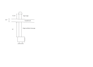

I purchased my wood stove a few days ago and I'm planning the installation, it'll be done by me. The stove will have a 22' straight up run of single wall pipe untill the roof, my problem is that the roof is made of concrete, a 4" to 5" thick poured slab, the problem I have is that I don't know what to use to connect the single wall pipe to the type A chimney at the roof. Is it possible that I can use a wall thimble for this? I'm attaching a sketch of my plan.
Please help... Valentin
