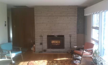

Morso 5660, Regency CI1250 Pacific Energy Neo 1.6 and Osburn Matrix are some clean minimalistic inserts. Note that all of these units require and existing fireplace to install into. Is this what you want or do you want modern looking zero clearance fireplace?

Osburn Matrix
