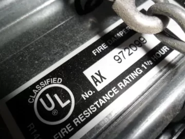

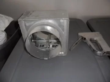

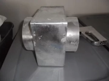

i, too, would like more information on how to get heat from downstairs to upstairs and still meet code. do explain these fire dampers. are they always open like the ones the op is using and you just close them manually in the case of a fire? thanks.hotprinter said:Hate to burst your bubble. But a register with duct hooked to it between floors does isolate it from the floor joists. But is not code and does not slow the spread of fire from the lower level to the upper or vise versa.
That is the purpose of the fire damper. It is to create more time for the fire to get between floors, rooms, etc, thus giving more time for evacuation.
REPLY:
It meets code in our area. Our codes may not be as strict (in rural Alaska) as they are in the lower 48. Check codes in your area before any remodel. Can you post a photo or website explaining a fire damper please.
Thanks
lethal dose said:do explain these fire dampers. are they always open like the ones the op is using and you just close them manually in the case of a fire? thanks.
