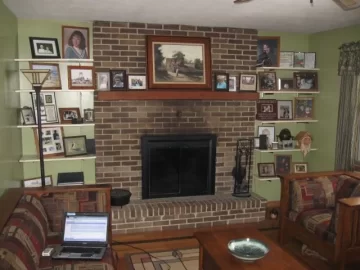

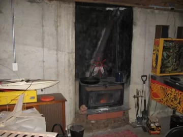

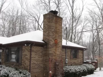

I have attached photos of the basement. living room above basement installation and outside of chimmny. The basement cealing where the flue is attached is poured concrete, the white stuff is high temp kao wool used in heat treating applications ( I used it to seal the gaps) When I opened the flue into the basement It was noted that the flue did not open into the alcove but was slightly offset.
Steve

Second - you are gonna loose tons of heat to the uninsulated cement walls.
Third - An exterior flue to your stove should have an insulated liner in my opinion. Without it, you will probably have creosote issues.

What is an exterior flue, pardon my ignorence but I am learning.
A flue that runs outside of the heated envelope of the house. They are notoriously difficult to heat up to the proper temp to ward off creosote production. An insulated liner is used to ward that off.
I agree that any exterior chimney should have an insulated liner. That pic is an exterior chimney.
