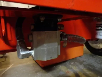

    Where is the leak, from a fitting, hose , around the shaft ?
    Can you get a pic of it leaking?

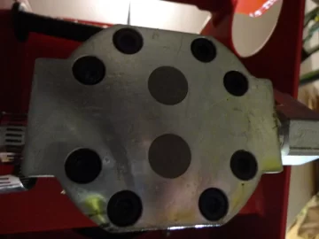

    Here is a couple of pics. Seems to be just coming from the bolts that are holding the bottom portion of the pump to the top portion of the pump. I have tightened these and it still is leaking. Today is the first time I have used this log splitter. I took a new one back last week because of the same issue. 291.JPG 292.JPG

    If it's not far to go i'd take it back and mabey look at different brands.

    I went and talked to the manager today at TSC and she said she could order me a new one if I want. She also said she had a new pump in the store that I could replace it with if I wanted to do that. I told her to let me call SpeeCo tomorrow and see what they have to say. I went back and tried to tighten all the bolts up again on the bottom of the pump and couldn't budge any of them. I'm looking forward to listening to what SpeeCo has to say.

    Updates? I am having the EXACT same problem with my 22 ton Huskee Log splitter. I brought one home two days ago and it was leaking at the bottom of the pump around the bolt heads .I took it back to TSC yesterday and swapped it out for another one. What do you know, this one is leaking at the same exact place. I called speeco and they said the pumps are put together at the factory and must be a bad batch of pumps? I am going to go exchange it for a third one, but this is getting rather annoying.

    Thanks OKchiefsfan..... I returned the second one today, they must think I am crazy at TSC, as they told me they have hardly any returned to the store and never heard of this problem. I am holding on to my money and will try a third one this fall when they can hopefully figure out this pump situation. Speeco didn't seem to concerned, as the rep told me me they manufacture 45,000 of these a year and may have 50 with issues. Well, I am not sure if they changed pump manufactures or a new gasket material etc, but I believe they are going to start seeing some issues when people become aware. Honestly, I do not think to many people look at the bottom of the pump to even notice. It leaks just a few drops everytime you use it, not noticeable to the naked eye standing up, unless you bend over and look directly at it
