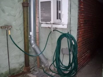

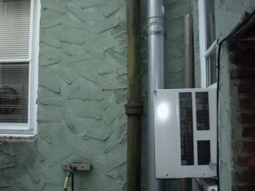

I have finally decided on a stove and now there seems to be a problem with location.Two dealer have come out and saw no problem with the location I have picked.The third whom I am buying the stove from said I cant install a stove where I have picked to install. There is a window and he said you have to be 18 inches away from a window there is 28 inches from the bottom of the window sill to the floor. Couldnt he go thru the wall there? There are also my main heater and sewer stack running up the side of the house on the outside could that be a problem? Do you have to be so many feet from either of the stacks?He also quote me with about 10 feet of exhaust pipe? Also said it would be about 825 just to break thru the brick of my house(100 year old philadelphia soft red brick) he said it would take the better part of the day for two men?The install is going to be 4500 for a floor model pc-45. 2700 stove,825 break thru brick,the rest for pipe? That seems high,I saw on line Simpson duravent kit for about 350? Just wondering about opinions on this? Tried to upload photo it was too big...Lisa
