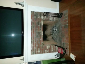

    hi everyone ...i have been reading this very informative site and decided i should join. i am in the massachusetts area and have a 1700sq ft house 2 floors somewhat open concept ...house is only 2 years old well insualted. i have been trying to get away with using oil and figured that i could put a wood insert into my fireplace on the first floor ....i looked at a jotul 450 and a vermont castings montpelier ....i guess im looking for my most efficient option and any other brands or recomendations ....now on to the difficult part im having ...the depth of my fireplace is 20 inches ...the hearth is 20 inches only 40 inches to work with and the people i talked to today were giving me a hard time saying that my hearth needs to be at least 16 inches from the front of the unit ....they want me to buy some type of pad that i dont really want as i have brick and its level with my floor ....the width of the fireplace in the very back is 19 inches and the height is 27 inch the width of the front of the fireplace is 36 inches i have plenty of room to the top of the mantle and sides of mantle ...also what is this blocker everyone keeps talking about installing ?

    Hello Justin, welcome to the forum. If you can post pictures it will help with giving you some better advice.
    Since you say your house is well insulated I guess a medium size insert with a firebox of ~2 cu ft would be sufficient. The two you were looking at would fit in that category. The problem is you will need at least 16 inches from the door of the insert to the end of your hearth. No building inspector or insurance company will let you get away with less. So you have the option of extending the hearth or looking for an insert that protrudes less than 4 inches into the room. I wanted to suggest the Osburn Matrix as it is a flush insert which would work with your hearth but I don't think it will fit in your fireplace opening. The Regency Alterra is another one but the firebox is really too small for your application. The Lopi Declaration may actually fit: http://www.lopistoves.com/product-detail.aspx?model=340#dim-tab

    thank you for the response ...i do like the lopi model you suggested ...i have wood that i use for my fireplace currently its from leominster and its some type of compressed logs ... i think they are called prestlogs ..they work great ......here are some pics

    I have the Declaration insert and my fireplace is pretty much like yours. It heats our 2000 sq.ft. colonial pretty well. The insert allows us to install it without extending the hearth due to the flush installation. The negative side of flush install is the effectiveness of heating your home will drop down to less than 10% w/o fan. I like it except that it's a bit too hot for mild climate and burn time is only about 10 hours. If you are in mild climate like me, you may want to look into catalytic insert instead.
    Oh..also your TV will need to be removed cause it'll be way too much heat going that way.

    good to hear that the unit works like it does ....problem though with the tv is that the way my room is and design the tv is staying put ...the unit wont be run without the fan and if i have to extend my mantle to block heat from the tv i will ....i get the room cranking with the fireplace as is and the temperature above where the tv is doesnt change much ...i use a laser temp to check it and it seems fine

    Your TV will be fine were it sit. My tv is on my mantal right above my insert.

    ok so i looked at the lopi and it looks like it will squeak into my fireplace and still leave me my 16 inches of hearth ...this is the decloration model ...next question is are there any other inserts that resemble the dimensions and the back of the lopi meaning that the back angles ...and also are there any people in the ma, nh ,conn, area that can recommend where i can purchase one of these for a descent price
