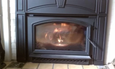

2. Glass is hard to keep clean. The corners especially get dark and even with hot fire and lots of flame, they don't self clean. And, it is hard to remove with basic glass cleaner and paper towel. The film in middle of glass wipes easily. Should my wood or burn technique be in question, or is the par for the course?

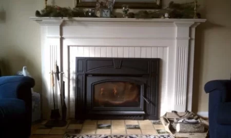

Here are a couple of pics of the Voyageur. Note the buildup on the glass. A hot fire with lots of flame only clears the middle of the glass.

I use the auto start up only for the initial lighting of fire. I push it in all the way, and can hear it clicking. I assume after 25 mins or so it shuts off automatically, as I cant hear it clicking any longer. I do not activate it again, even when reloading. When I re-load, I do not load the firebox completely. 1/2 to 3/4 is about all I have done. I could try filling the empty space with small rounds and see how much longer I can get. Seems to me most of the "burn time" is a hot coal bed, not active flames.
