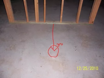

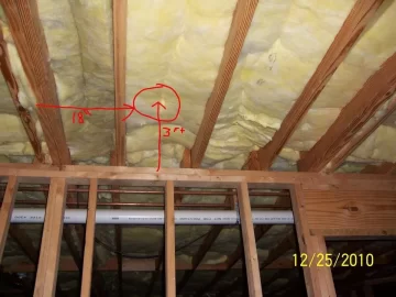

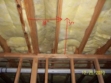

Getting ready to install a new VC Defiant and figured I would need extra support in the basement directly under the stove and hearth. After taking some measurements now I am wondering if it is really necessary. VC lists the defiant at 480 lbs. I am intending on a minimally weighted hearth made of metal studs, wonderboard, and whatever thin stone/tile the wife picks out.
From the pictures you can see the stove would fall on center around 3 feet from a supporting wall. The joists are 2x10 on 16" center, which I assume is standard. I am also very fortunate because the stove would be very close (18") to a triple joist. There is another triple joist a few feet to the other side as well.
My thought are I should be fine but wanted to ask here first.
