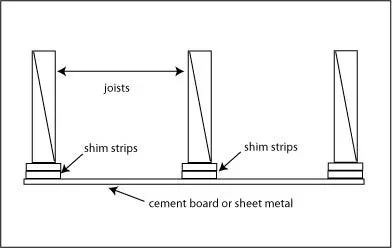

This is a big heater, personally for peace of mind, I would install a NFPA heat shield above the stove matching the hearth dimensions. If I remember right, Elk got called on this by a local inspector for a donor stove. But best to get the official word from Englander.

The cement board needs spacers to keep it 1" off of the combustibles (rafters). You could use doubled up 3" wide shim strips of the cement board to make the spacers.

As I noted, I don't know what the ruling should be here, but personally would rather be prudently cautious. A couple sheets of durock are cheap protection. Maybe I'm being overly cautious, but when BB describes this stove as heating his community, I treat it with respect.
