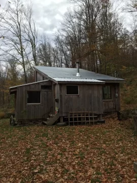

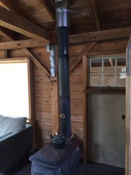

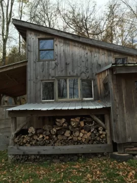

Some pics so you can see what I'm dealing with.
Existing chimney -

Stove -

Chimney pipe is much more costly than connector pipe. Not sure what is presently installed. It looks odd. Is that galvanized pipe or stainless chimney pipe?
The stove clearances to combustibles appear to have been ignored completely. That box stove is supposed to be 36" from the nearest combustible, in all directions.
Reactions: showrguy
A good part of the reason I'm replacing the entire system. It is a rustic hunting cabin, but I don't want it to kill me.
Not sure if you can make it out but the white board is a non-combustible cement board. Though whether that's code or not I couldn't say. My guess is that he originally intended to have the stove centered on that. And made do with whatever he had on hand for the pipe. There is a slate piece underneath, but that also is too small for the stove.
