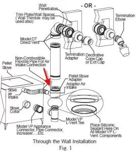

(3) Are there all-in-one OAK & vent pipes or will I need to install separate pipes for the vent and the OAK? If you use an all-in-one, do you have to seal off the back of the stove or does the pipe have a "y" at the end? Any recommendations for brand of pipe?
