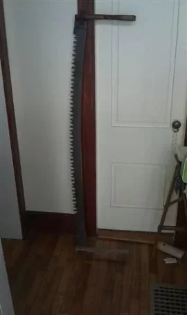

    is this the place to post a picture of mine?

  12. iskiatomic Minister of Fire
    joined: Nov 15, 2008
    695 posts
    Central CT
    OMG!!! A hand saw! I thought those were just for decorations!

  13. Black Jaque Janaviac Feeling the Heat
    joined: Dec 17, 2009
    441 posts
    Ouisconsin
    It's decoratin' the door can't ya see?
    But yes some of us still use 'em.

  15. zzr7ky Minister of Fire
    joined: Jun 12, 2006
    996 posts
    Saws with plenty of back like the pic can often be opperated by one man.
