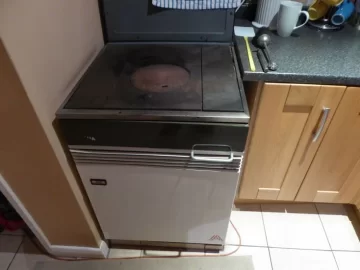

    Hello begreen It’s not had any work carried out on it, just the ash around the water jacket cleaned about once a year, it’s still working tonight in our kitchen as I speak, the only trouble is the air stat is not working as good as it did 30 years ago, but still works, I would change the stat if I could find a new one, it’s mostly burnt wood over the years and our house has been very well heated.
    I ran the flu up through the center of the existing chimney which heats the brickwork up and helps to keep the house warm during the night.
    Two years ago I have fitted an oil boiler in parallel with it as we are getting older now, which we have on for the first couple of hours in the morning just to warm the house up first thing when it’s really cold.
    I still have the Installation Instructions that came with it, this one is the Tirolia KS-L25
    Tony

    Wow, thanks for the picture. With a cover on top I would have mistaken it for a refrigerator.
