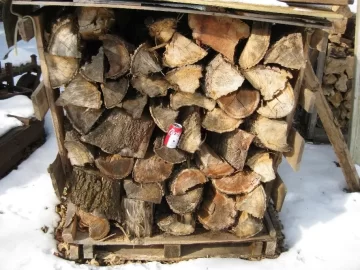

[Hearth.com] Optimum size to split wood? Wood this size [and some bigger too] fit in a Garn boiler. One year drying. They are not fussy.
