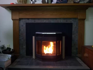

I finished up the install this morning. Got everything buttoned up and lit it off.....manually of course. It took a few minutes to get going but took off after that. It's been single digits to low teens all day and it's 73 degrees in my vaulted ceiling living room. I had been running the St Croix flat out on setting five most of the winter and the oil furnace has been running intermitantly to keep the house at 65 for the last few days. This Integra really throws the heat! I'm running at about 2/3rd's of max setting. I tweaked the auger trim up a little as there was very few embers staying in the pot. Seems pretty good now. The auger motor was a little noisy at first but quieted down. The convection blower on this stove really moves a lot of air through the stove. Outlet air temps are not quite as high as the St Croix was but the volume has got to be two or three times as much. I was pretty amazed at how quickly the room temperature changed once I cranked it up a little. The room was 74 degrees pretty quickly and it was getting warmer so I turned it back to try to keep it at 72 or so. Here's a picture of what it looks like. The decor panels are a mocha brown color and the top piece is bare aluminum. The stove is ugly but I can make it look a little better with some sandpaper and stove black.
Interesting I have never seen that panel configuration before. Mine is white on the top and side panels.
It's not stock. I think the guy who owned it before me ran out of paint......
