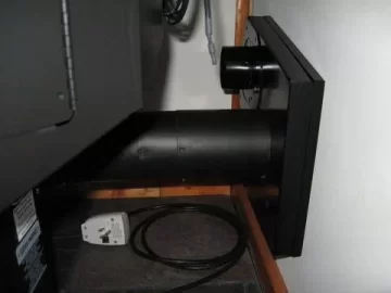

Hello,
I am curious about something. My outside air intake pipe is a flex pipe of sorts, one end connects to the thimble and the other to the stove of course. The pipe just slides inside each point of connection. Should this pipe be connected with a screw or something? Or is it normal that it just sits in there? Should I seal each end where it enters the thimble and stove? Here is a pic of the setup, the outside air intake is disconnected.

It would beneficial to put a pipe clamp on each end otherwise it could draw in some air from inside the home. Also, if the power went out you could get some smoke leaking from there. Sealer is not really needed but wouldn't hurt.

Hi,
That's kinda what I thought. I can't put clamps on the pipe though because the pipe actually goes inside the outlet. The diameter of the pipe is actually smaller than the connections at the wall and on the stove. When I was cleaning out the back of the stove I saw a lot of dust, etc around the air intake so it made me think about the original setup. I think I may buy some larger diameter flex pipe from an auto parts store and get a couple of clamps too. That way I can tighten everything down.
On my P-38 (which is almost the same as your P-43 but no auto light feature), I did have a small set screw on the pipe going into the stove; however, I'm not sure if any type of sealant was used.
I would put a silicone (500* Stove RTV) sealer on it. Just so that when its not running. That air does not come in through the small gaps on the ends. Harman uses the internal butterfly, but that does nothing for those 2 ends on the inside of your house. Or clamps could be used. Eithed way I am sealing it. I have a few bottles (different heat levels - 500*, 750*, 1200*) laying around the house. It couldnt hurt.
If the inside pipe is small enough another thing that works well is to fill the gap with the ribbon gasket that is used for the glass in stove doors. Seals the gap, is fireproof and easy to remove if you need to take the pipe out.
Mine was installed by a pro, he used silicone, and no clamps. So far, so good (1 year ago).
Ohio P43 said:
I use aluminum tape...airtight seal.
Same here, seems an easy solution. I just keep ck on it to make sure it keeps intact. would be so easy to replace if needed.
Right from the beginning (and 2 stoves) I have always found aluminum tape to perfectly seal the joints in all my pipe. I never had a whisp of smoke or odor. Silicone is a real PIA to remove. The alum tape goes on and comes off easily and cleanly.
