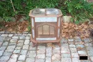

"I'm almost starting to feel that if I change anything, it may not be for the better. The stove burns fine without the OAK. I don't know if changing any part of the equation will result in less effective performance. I was starting to feel like the outside air would help, but now it seems I may relly on the old saying: if it ain't broke don't fix it! Thanks for your input once again Todd!"[/quote By the way I saw a Woodstock Fireview on CL, what do you think?(broken link removed to http://boston.craigslist.org/bmw/hsh/1550597599.html)
Here's a pic I forgot to attach.
